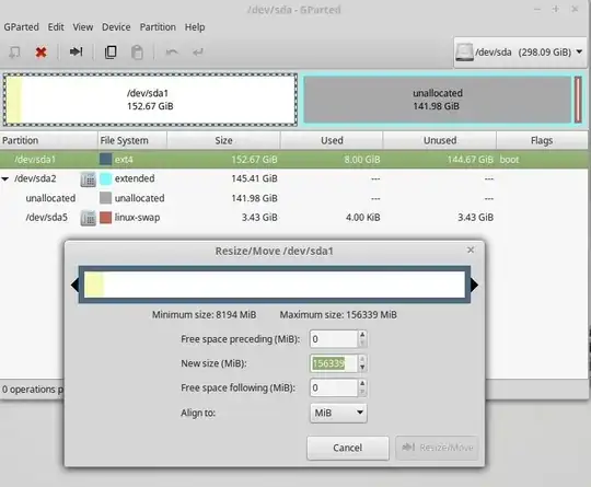

Tried booting with linux mint from bootable usb, and running gparted, but in that case I can't to anything with unallocated space either. I can only resize
my disk partitions
The dev/sda1 can be shrinked only... I'd like to have a 294 gb hd instead... the unallocated simply doesn't show any options or commands (all grayed out)
If I enter any number on dev/sda1 in "free space preceding" (or following), that is substracted from "new size"....

I guess what I need is to delete the sda2 partition, how do I do that?
