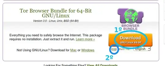

Run Tor Bundle 'Portable'
You can run tor without installing it (yeah, someone could consider this off topic here).
  1. Download the latest version of tor from the website and open the signature of the file
    download_tor_and_click_on_sig

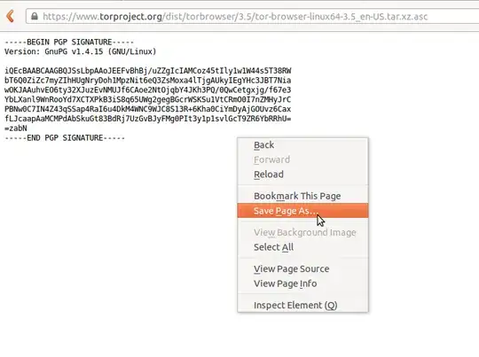

  2. Now you will see the PGP signature, save it on the same place than the Tor bundle
    right-click_and_Save-page-as

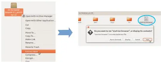

Now extract it, open the folder, click on start-tor-browser and run!
extract_open_click_run
