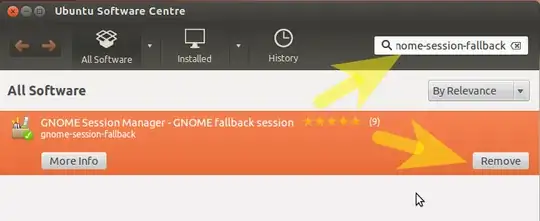

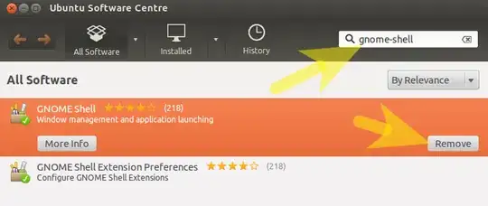

Gnome-Shell and Gnome-Classic (also known as gnome-fallback/gnome-session-fallback) can be simply removed from the Software Center:
search for gnome shell
search for gnome-session-fallback
remove all packages
However, removing from the software center does not remove every package originally installed.
