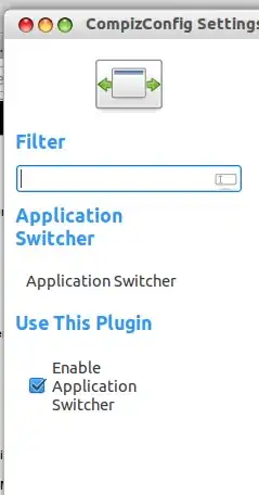

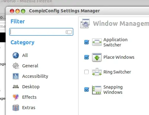

Hi Type as ccsm in your terminal and then It will Open your Compiz manager.Then Select Window Management, Select Application Switcher and it will open another windows as shown in second Image . There enable Application Launcher will be there . Select It.
and you are done. Hope that helps.
enter image description hereenter image description here
