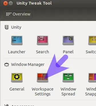

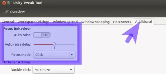

Follow-on-focus settings can be set using the unity-tweak-tool Install unity-tweak-tool

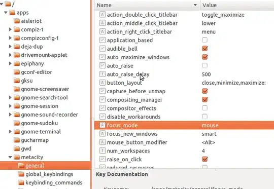

Use gconf-editor and change the focus-mode value shown to mouse or sloppy
(see note below)

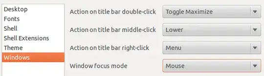

use gnome-tweak-tool
change windows focus mode to mouse or sloppy
(see note below)

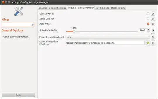

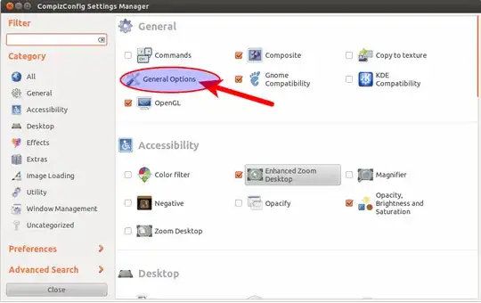

This can be done through CompizConfig Settings Manager. I've tested it on 11.10, 12.04, and 12.10, and Elder Geek successfully tested it on 14.04. and 16.04
CompizConfig
Select the "Focus & Raise Behavior Tab", then uncheck "Click To Focus." Make sure "Auto-Raise" is checked.
More CompizConfig
If you don't have CompizConfig Settings Manager (also known as 'CCSM') installed, you can do so from the Software Center, or from the command line:
sudo apt-get install compizconfig-settings-manager
You can then launch it with as ccsm from the command line, or from the launcher with "compiz" or "ccsm",
