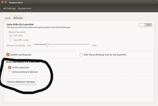

I recently had to do a full reinstall of Ubuntu 16.10 on my laptop and lost all my files and settings.
I really like having the focus move with mouse or sloppy settings, but when I opened Unity Tweak Tool and set it to that, I realized that I couldn't access the window settings. (usually in the menu bar on the top of each window) it was in the launcher, and I can't find the setting to move it anywhere!
I know I was able to do it before, and I don't want to give up my auto-focusing mouse.

For focus follows mouse and "sloppy":
See the answers here.
For the menu bar:
Go to System SettingsAppearanceBehavior and adjust in the section circled below:
titlebar
