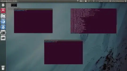

See all the windows of one application:
I'm not sure what exactly you want. To see all windows of e.g. the terminal, I can click on the launcher icon twice. This results in this image:

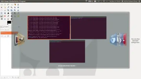

There is also the application switcher (Alt+TAB) where you can use the arrow keys to show all the windows of one application:
