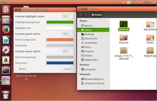

There is a GUI to do this, available here. For versions before 13.10, you would need to add this PPA, but since 13.10, you can just install it from the main repos with:
sudo apt-get install gtk-theme-config
Once installed and set it can do a great job - though buttons, and other highlights based on images will likely persist in their original colour.
After making changes (make sure you turn the switches to ON), you need to logout/login to see most of the effect - here is an example with incredibly bad colour choice:
