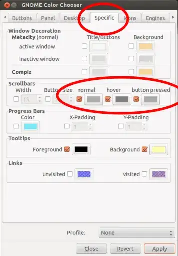

A bit late, but perhaps I've found a quite nice, easy GUI solution:
gnome-color-chooser Install gnome-color-chooser
scrollbar settings in Gnome Color Chooser
Highlights:
  • Completely GUI solution, no need to manually fiddle with ~/.gtkrc
  • Only changes the settings you check. Uncheck them revert to default.
  • Changes are applied as soon as you click Apply. No need to switch themes back and forth
  • No need of sudo (but changes are to your user only)
  • Applies to "legacy" scrollbars only (the ones that need to be fixed). The "overlay" scrollbar is not modified.
The changes are quite unobtrusive: it edits (or creates) ~/.gtkrc to include its own config file:
include ".gtkrc-2.0-gnome-color-chooser"
And that file is pretty slim too:
style "gnome-color-chooser-scrollbar"
  bg[NORMAL] = "#ACACAC"
  bg[PRELIGHT] = "#808080"
  bg[ACTIVE] = "#ACACAC"
widget_class "*Scrollbar" style "gnome-color-chooser-scrollbar"
Btw, I've picked the above colors out of experiments. They blend in nicely with Ambiance's "monochrome-ish" style, being just a bit darker (and thus more visible) than default.
Until Firefox gets overlay scrollbars, I'm quite happy with my custom colors :)
