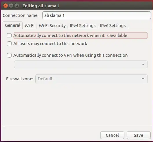

I faced the same problem before, NetworkManager taking about 8 seconds. There are three ways to solve this problem:
  1. Disable connecting automatically for your connection
    edit connections > select your connection > edit and disable connecting automatically
  2. You can simply disable Enable networking from network indicator.
  3. You can disable the service by running this command
    systemctl disable NetworkManager-wait-online.service
