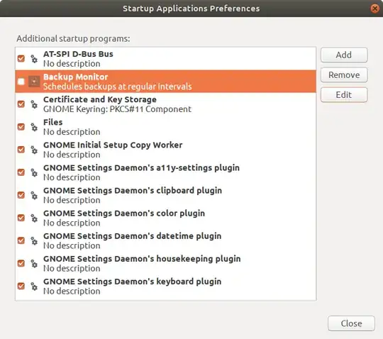

2. Startup applications
Another step to speed up userspace load delay is to disable some startup applications
See how to show all of them : https://help.ubuntu.com/community/ShowHiddenStartupApplications
sudo sed -i "s/NoDisplay=true/NoDisplay=false/g" /etc/xdg/autostart/*.desktop
See how to open the Startup Applications applet : https://help.ubuntu.com/stable/ubuntu-help/startup-applications.html
 gnome-session-properties
If you dont mind, disabling Backup Monitor and Updates Notifier will save boot time.
