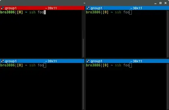

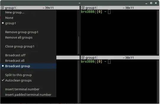

Use a terminal emulator with broadcasting
Terminator, for example, is a terminal emulator in which you can broadcast keystrokes to a group of terminals.:

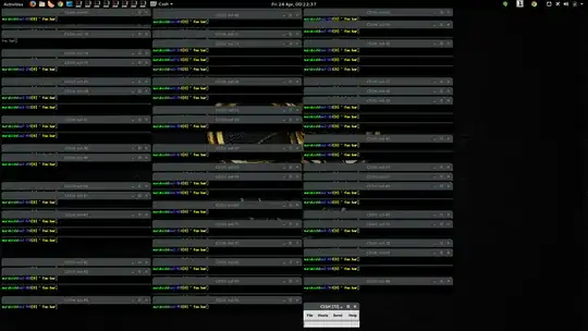

Depending on how many connections you make, Cluster SSH might be the better option. However, it uses xterm for the terminal emulator, which may not be what you are used to. It is, however, much more easy to get started with a number of connections using cssh, than to create a lot of splits and group them in Terminator. For example, this is what cssh osl-{01..95} gets me:
The terminal windows were are all resized and tiled nicely. The gaps are for windows that were closed because the connection failed.
