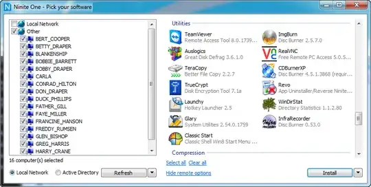

To give you an image on what I want, is this, select my client and install the software I want to install on it, from my server!
Ninite Pro: The easiest way to manage software.

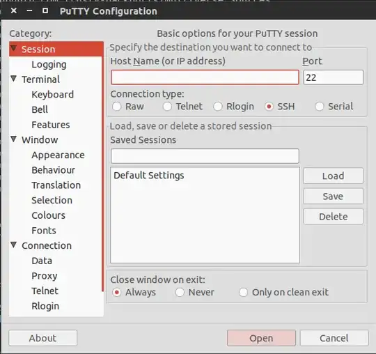

An extension to @kos's answer. I found a GUI client for SHH, for Linux. Putty, a free telnet/ssh client. It resides in the Ubuntu Trusty Tahr repository:
I looks pretty straight forward, as seen here on this screenshot:
