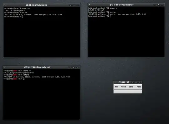

One that I have used is ClusterSSH to send to multiple terminal windows at once.
sudo apt-get install clusterssh
ClusterSSH will open its own terminal windows that you can send commands to with the application. Once in ClusterSSH press Ctrl+Shift++ or click on Hosts in the menu and select Add host(s) or cluster(s) and type in all you want open separated by space between each one. You should get a window looking like this one:
then any command that you want to send to all the windows at once you type in the box below the File Hosts Send Help menu items.
I have also written a script that you can run from a command prompt to open as many Cluster SSH windows as you want. I do recommend that before you use this script to run ssh-copy-id localhost so that it launches without asking to enter a password.
