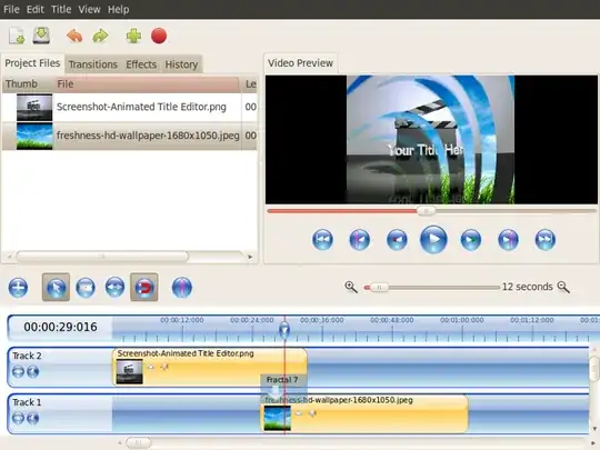

Openshot
Install via the software center
OpenShot can take your videos, photos, and music files and help you create the film you have always dreamed of. Easily add sub-titles, transitions, and effects, and then export your film to DVD, YouTube, Vimeo, Xbox 360, and many other common formats.
alt text

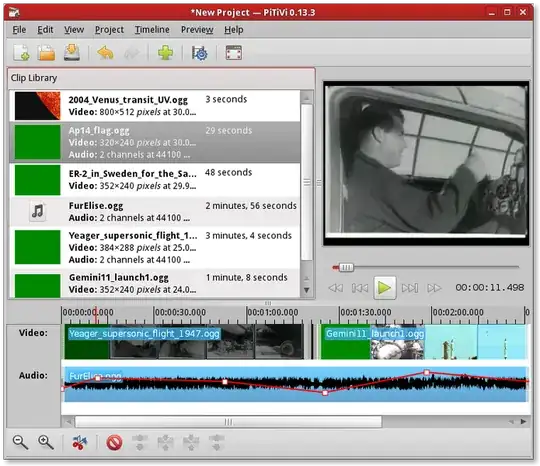

PiTiVi:
PiTiVi is an easy-to-use video editor targeted at beginners and intermediate users.
PiTiVi Screenshot

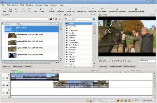

I have found kdenlive to be very easy to use and serves most editing needs very well:
I understand it is now available for other desktop environments as well. Hence made it a separate answer so others can vote up their choice.
from their website

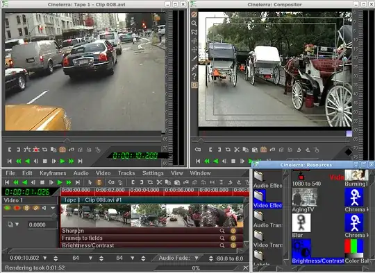

Cinelerra
A non-linear video editor and compositor for Linux. It also allows users to perform common compositing operations such as keying and mattes.
Installation guide for 12.04 & 12.10
Avidemux
Avidemux is a free video editor designed for simple cutting, filtering and encoding tasks.
Kdenlive
Kdenlive is an intuitive and powerful multi-track video editor, including most recent video technologies.
Comparison
Cinelerra is used for professional work. It is very fast, and can handle a heavy load.

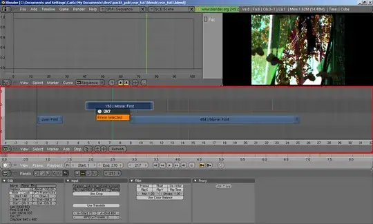

blender is a very capable option. It's essentially a 3D-modelling and animation platform, but also has video editing capabilities (which I haven't tested yet). It's worth giving a go, but I'd recommend watching some tutorials first, as the UI has an unusual logic, which takes a while to get used to. The interaction model is very consistent though, and optimised for productivity. Overall, it's one of the most mature and impressive graphic design packages with an open license Blender

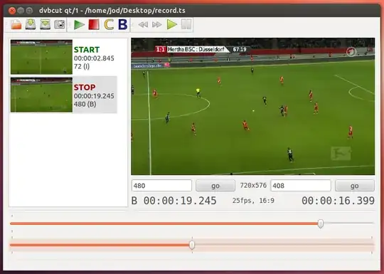

DVBcut
DVBcut is a Qt application that allows you to select certain parts of an MPEG transport stream (as received via Digital Video Broadcasting, DVB) and save these parts into a single MPEG output file. It follows a "keyhole surgery" approach where the input video and audio data is mostly kept unchanged, and only very few frames at the beginning and/or end of the selected range are re-encoded in order to obtain a valid MPEG file.
dvbcut
If you have a DVB recorder or a digital TV card and want to cut off some parts from your recordings (like commercials) frame-exactly without re-encoding the whole file, use DVBcut. Not suitable for most other purposes.
Documentation about how to use it you can find on it's homepage.
