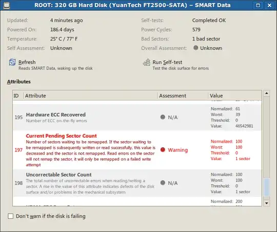

To check for bad sectors check the SMART data, probably the best accessible by launching the Disks utility (Palimpsest). Even if you don't see any bad blocks there, launch a self-test to be sure.
The program is bundled in the gnome-disk-utility package. Run gksudo gnome-disks
SMART from Palimpsest

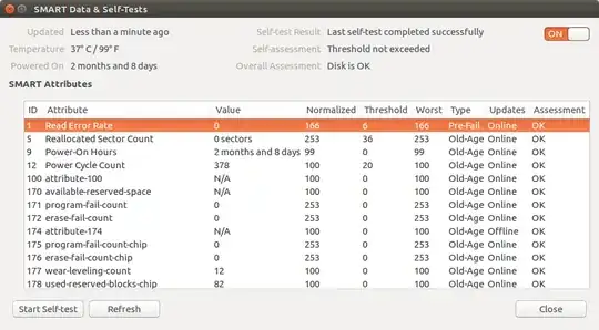

Or in Ubuntu 16.04 version (3.18):
SMART from Disks
