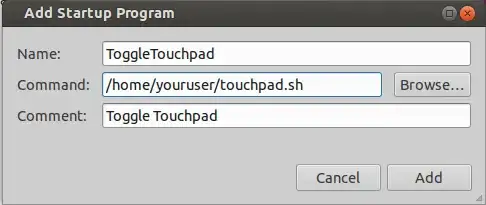

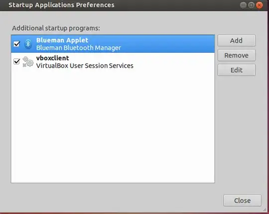

  2. Add the script to Unity's autostart files
    Open Startup Applications (search in the dashboard for "Startup")
    Click on "Add" and then paste the path to your script in the command field:
