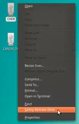

When I right-click the desktop icon for my USB drive or SD card I have the choice to "Eject" or "Safely Remove Drive":
screenshot

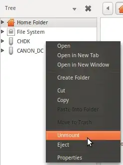

In the Tree side pane in Nautilus, I can either "Unmount" or "Eject":
screenshot

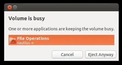

There is however a verification process that runs when you try to Eject a device that needs sync. For example, if you try to eject a device that is copying data at that precise moment, it will give you the following warning:
If you try to Eject the device and the sync is not done yet, you will get a message along the lines of "waiting for sync to finish before ejecting device". This only shows or at least it gives you enough time to see the message if you copy a lot files, specially small ones mixed in with big ones and then immediately after finishing the copy process you try to Eject it.

Safely Remove Drive
This option differs from the others since it is specifically design for synced devices like USB Hard Drives, Pen Drives, etc.. It will sync the device, unmount it and then power it down. This option should be available for devices that need sync, although Eject has taken some of the properties of Safely Remove Drive.

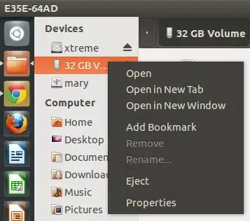

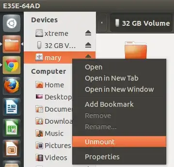

Here are some pics that show what you can see when you try to disconnect the device:
As you can see in this image, a Pen Drive / Flash Drive has the "Eject" option enter image description here
An external USB Hard Drive has the "unmount" option enter image description here
An external USB DVD Drive has the "Eject" option
