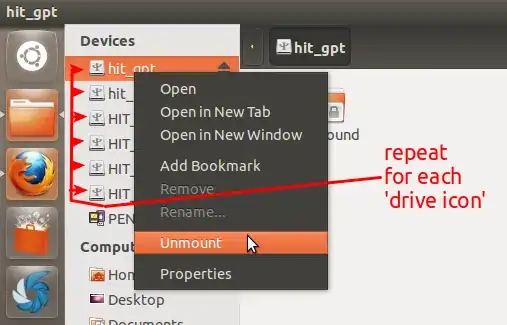

To safely remove i.e. disconnect an external USB drive you need to manually unmount all of its partitions (represented by 'drive icons'):
either in Unity Launcher
or in Nautilus
In the example above: to remove my Hitachi external USB drive I have to unmount all of the partitions on the said drive. To make things easier when formatting my drive I named (labelled) all of its partitions so that the names (labels) begin with 'HIT'.

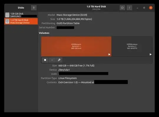

Gnome Disks Utility has an option to Power off a disk.
You can first unmount the partitions as suggested in other answers or using the Gnome Disks Utility as I explained below.
  1. access gnome-disk-utility searching for 'Disks' on Gnome Applications Menu or typing gnome-disks on a terminal.
  2. Select the disk in the left list
  3. Unmount the partitions clicking on each of them and clicking on the Stop button for each of them.
  4. click on the Power Off button located on the window top bar. Gnome Disks Utility screen
