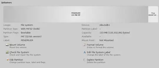

If I were to guess it sounds to me like your Pendrive is corrupted. the simple solution is to back-up and reformat however if you want to find out if it is really corrupted or not which could be a sign of a failing flash drive use fsck
first back-up your pendrive/card then find out what mount point its under eg. /dev/sdb , /dev/sdc etc.
You can find this information in disk utility under the heading Device:
in the screen shot it is /dev/sdb1
You can then modify these commands and run each
sudo umount /media/disk
sudo fsck -favVr /dev/sdb1
Alternatively you can click "check file system" after unmounting the drive in disk utility
Disk Utility
