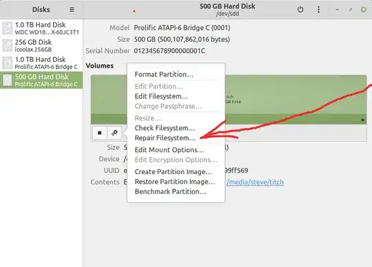

I couldn't easily take my problematic NTFS-formatted external drive back to the Windows system that had apparently failed to dismount it safely (causing Mint to insist on mounting it "read-only").
But the easy answer for me was to run the Mint "Disks" utility and select "Repair filesystem"...
