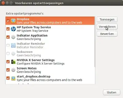

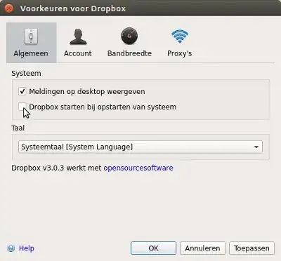

  • in Dropbox preferences, untick "Start Dropbox on startup" (else we would have two .desktop files representing Dropbox in the autostart folder):
  • In Startup Applications (Dash > Startup Applications) remove the Dropbox entry (but not the newly created start_dropbox.desktop).
  • In the folder ~/.config/autostart, remove the original dropbox.desktop if it is still there.
Now on restart, it should be in the right place.
