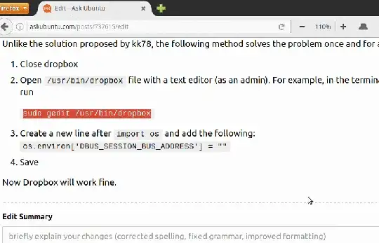

This instruction only work for Xubuntu, UbuntuStudio 16.04 (Not working in 17.04)
In you terminal run
sudo gedit /usr/bin/dropbox
Create a new line after import os and add the following:
os.environ['DBUS_SESSION_BUS_ADDRESS'] = ""
Save and rebot
Here a Gif I made:
Gif tutorial
And, if someday Dropbox update and not working more, repeat this tutorial
Reference:

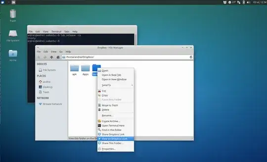

To get Dropbox integration in Thunar:
sudo add-apt-repository ppa:xubuntu-dev/extras
sudo apt-get update
sudo apt-get install thunar-dropbox-plugin
Thunar integration
