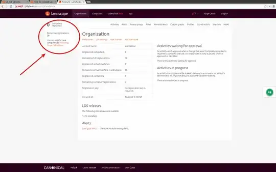

You should then see the web UI after filling in your name and contact details:
Account dashboard with 20 remaining registrations
Click on the link highlighted to add client machines:
Registration instructions
Follow those instructions on the client you want to join to Landscape. Note the following line:
sudo landscape-config --computer-title "My Web Server" --account-name standalone  --url https://<servername>/message-system --ping-url http://<servername>/ping
You can customize the title and so forth for each machine. See the landscape-config man page for more information.
After you type in the landscape-config command the client will ask you some questions, those are optional, you can just hit Enter until the client restarts, then you can accept the client in the web UI.
