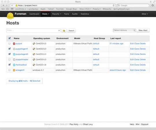

In addition to straight Puppet and Spacewalk, there is a puppet-based system called "foreman" that does most of what you're looking for.
while the screenshot does show CentOS and Windows clients, it does have Ubuntu support
I've used it and I recommend giving it a go.
