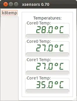

xsensors Install xsensors
sudo apt install xsensors
It has a graphical interface that is easy to understand. It shows me the motherboard voltages (there are four of them), the CPU and motherboard temperature as well as the CPU fan speed, the speed of three chassis fans and the power fan speed. All monitored in real time. And it loads into the the Unity Dash.

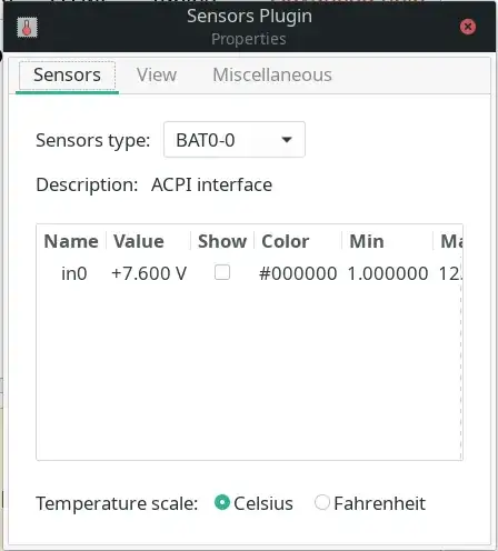

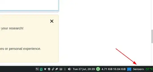

If you use XFCE, I think it`s better to show it in toolbar, like this, use this plugin:
The effect is this:
2:
