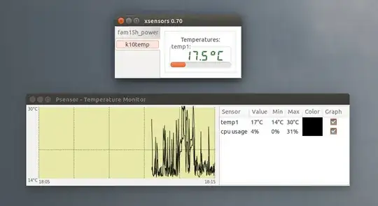

I'm trying to read my temprature sensor values using Xsensors and Psensor, but both programs only show a single value - what I suspect to be the CPU core temperature.
Here's a screenshot to illustrate:

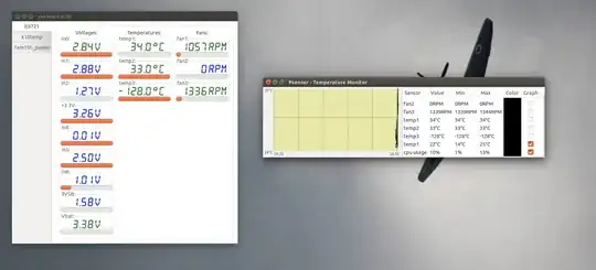

Screenshot:
screenshot of working programs showing the values
