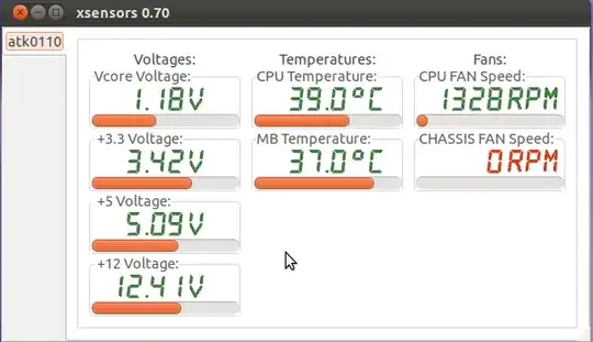

We can simply do this by installing "Xsensors":
http://apt.ubuntu.com/p/xsensors
This application will install "lm-sensors". If the addon is not selected there, you need to select it.
After you install xsensors, you need to configure lm-sensors.
To do so, open Terminal and run:
 sudo sensors-detect
just press ENTER for everything it suggests. Lastly it will show whether to add what it finds to /etc/modules. Hit Enter again and you are done.
Now open Dash and search for xsensors.
