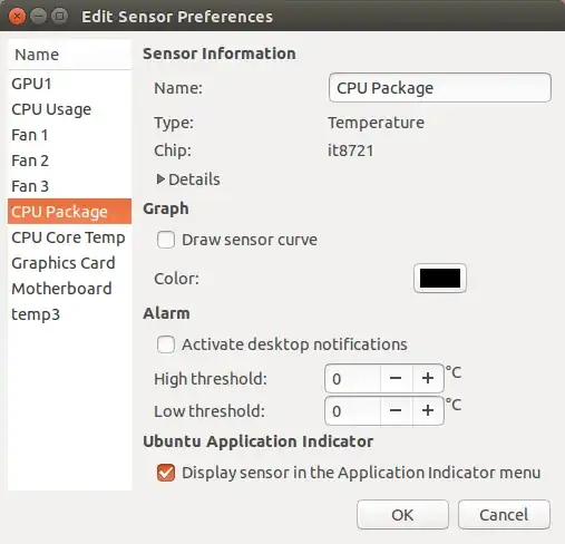

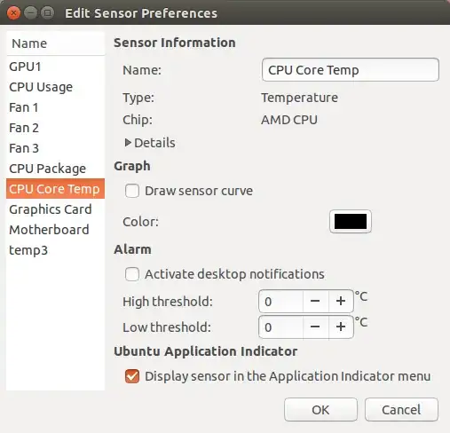

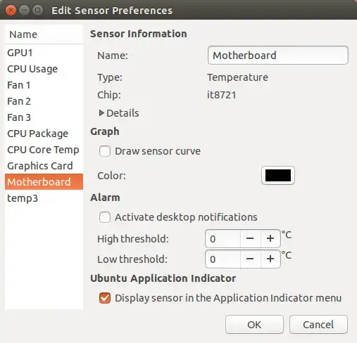

I run an FX6300 on an M5A97 R2.0 (So my results should be very similar)
You should install Psesnor. It's like Hwmonitor for Windows.
sudo apt-get install psensor
psensor
Terms:
CPU Package = the temperature of the CPU socket, as measured by the motherboard.
CPU Core = the internal temperature of the actual cores on the CPU (This is the one to watch)
Motherboard = the temperature of the south bridge
Some Notes:
The CPU core temp will always be lower than the socket temp, since the CPU has active cooling, whilst the socket does not.
Since the FX6300 is a 6-core CPU, you would expect that each core has a temperature sensor. There is some confusion about this. It seems that only AMD's overdrive software can detetct all 6 of the FX6300's core temp sensors. However, all the cores will be within 1-2C of each other
Temps in Psensor:
I have renamed all the temps so I know what is what. If you look at the "chip", you can know what is what and rename them like I did.
Motherboard
CPU Core Temp
CPU Package / Socket Temp

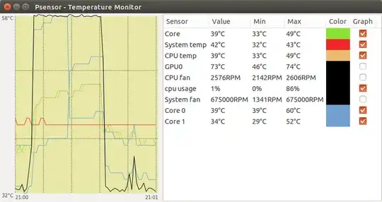

You can readily see which temps are from the cores by graphing the output using Psensors while you stress them. Install stress with sudo apt-get install stress. For example to stress both cores of a dual core CPU for 10 seconds use stress -c 2 -t 10. Here is the result of stress -c 1 -t 30 on my dual core PC. You can see that the first 15 seconds are run on core 1 then the load switches to core 2.
