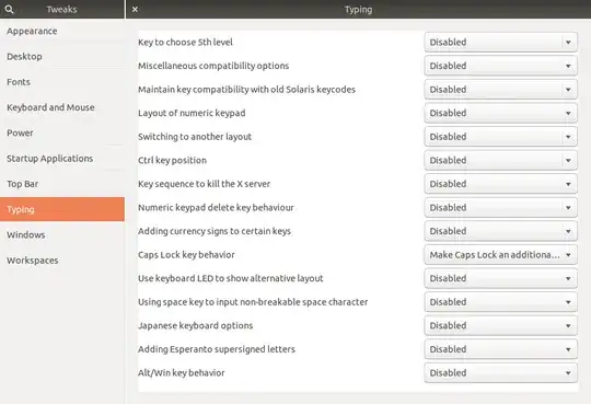

Install the GNOME Tweak Tool (gnome-tweak-tool), under the Typing tab there is an option to swap Esc with Caps Lock. This worked for me in Ubuntu 14.04.
gnome tweak tool typing section
