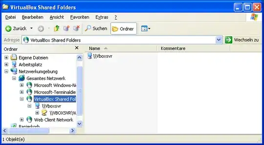

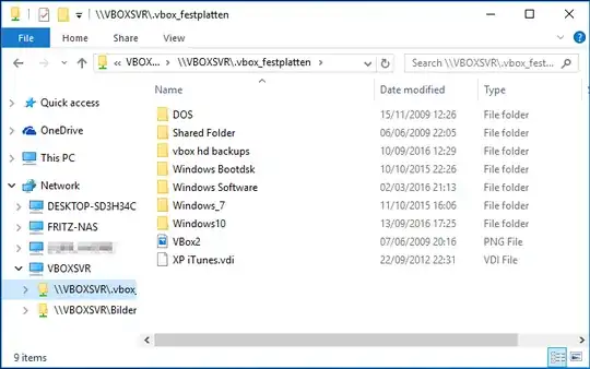

After that you may define a shared folder as outlined in this answer. However in Windows you don't "mount" it but instead you take the following steps (from the user manual of Virtual Box):
In a Windows guest, shared folders are browseable and therefore visible in Windows Explorer. So, to attach the host's shared folder to your Windows guest, open Windows Explorer and look for it under "My Networking Places" -> "Entire Network" -> "VirtualBox Shared Folders". By right-clicking on a shared folder and selecting "Map network drive" from the menu that pops up, you can assign a drive letter to that shared folder.
If you don't see any entries coming up in the Browse dialog, you can manually fill out the Folder: field with \\VBOXSVR\<folder-name> where <folder-name> is the share name of your folder.
Screenshots for Windows Explorer (German locale)
Windows XP
Windows 7
Windows 10
