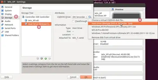

Seems that your virtual guest not detecting your host CD drive. So, first make sure you have installed guest addition. Then choose your host drive going to Settings --> Storage and then choose your host cd driver:

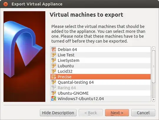

The fastest, safest, and only recommended way to backup your Virtual Machine is mounting an external drive on your host system to then export the Virtual Machine from Virtual Box Manager File -> Export Appliance.
Select one or several virtual machines to export.

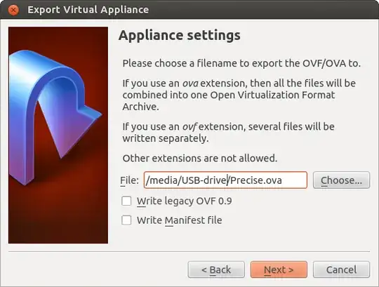

Choose the mount point of your external storage device.
Only exported virtual appliances can easily be re-imported with all their settings to a new instance of Virtual Box.
The size of the exported machine will be considerably smaller than the virtual hard drive size if you had chosen a dynamically growing drive.

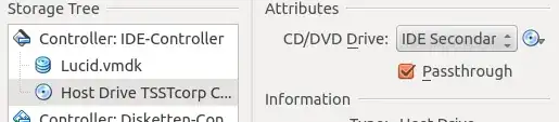

To access to your host DVD/CD-ROM drive for write access you will have to enable passthrough in the storage menu as shown in the answer above.
