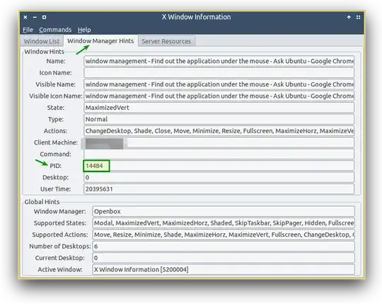

Using wininfo
Wininfo is a graphical utility that displays various information on windows and their properties, including the PID (process ID) associated with the window:
image of PID in wininfo
wininfo should be available in the official repositories:
sudo apt-get install wininfo
Having determined the PID of the window you can then look up the process name associated with it. There are various ways to do this, e.g. by looking at /proc:
$ cat /proc/17002/comm
gnome-terminal
This would be the process name associated with the PID 17002.
