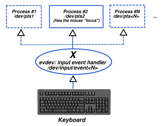

In a typical Linux graphical desktop, processes don't talk to the keyboard directly. Instead the X program (Xorg) controls all the keyboard events via a device /dev/input/event<N>. X uses an event handler (evdev) which among other things, handles keyboard events. You can also verify this by looking at the X log: /var/log/Xorg.0.log where keyboard is mentioned.
The keyboard events are forwarded from the X event handler to the process that has the mouse pointer focus at any time via the process standard-input which is open on /dev/pts/<N>. Strictly speaking: a process doesn't actually "grab the keyboard", the keyboard is held by X, the process only has (or grabs) "focus" or the attention of X so X can forward keyboard events to it via an open stdin file descriptor on /dev/pts/<N>.
Diagram of keyboard events multiplexed via X evdev
