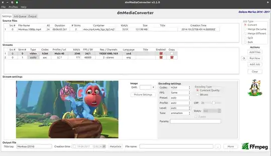

You can use my application, dmMediaConverter. Just leave "copy" for both streams checked (no transcoding) and put .mp4 to the output file name. That's it. Very simple. http://dmsimpleapps.blogspot.ro/2014/04/dmmediaconverter.html
