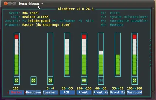

Hello I have tried out the program "EarCandy", now I had/have a lot of problems. At first I did not get any sound and now it is very low volume. PS Earcandy is now deleted from my hard disk.
When I open the Alsamixer with:
alsamixer
I see that the volume for the speakers is zero. I push it to the max volume. But after every restart, I have to open alsamixer again and have to set the volume to max again. Can I save the settings for alsamixer or is there any other way to fix the problem ? enter image description here
