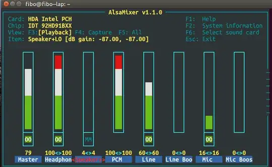

Since I've upgraded to Ubuntu 16.04 LTS I have the following problem: When I plug in the headphones they are muted and to resolve this I have to un-mute the "speaker" in alsamixer, as seen in the image.
Is there any way of reverting it to the regular behavior?

Edit this file:
/usr/share/pulseaudio/alsa-mixer/paths/analog-output-headphones.conf
Comment this 2 lines just putting a ; in front of the lines
[Element Speaker]
; switch = off
; volume = off
Restart pulseaudio:
killall pulseaudio
pulseaudio --start
