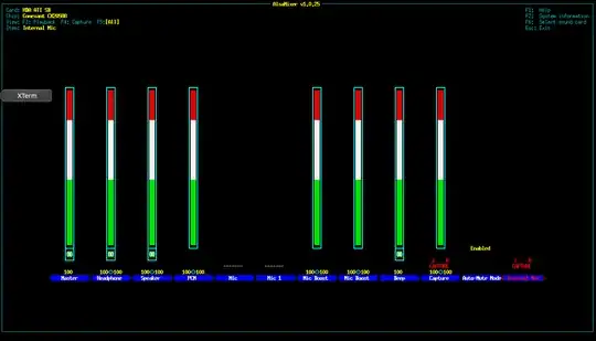

  1. Open a terminal
  2. Run alsamixer (pictured in original question)
  3. Use left/right arrow keys to select "Auto Mut"
  4. Use up/down arrow keys to Disable Auto Mute
  5. ESC exits
https://superuser.com/questions/431079/how-to-disable-auto-mute-mode http://www.tutonics.com/2012/10/fix-no-sound-turn-off-auto-mute-in.html
To save settings try sudo alsactl store (untested)

Add the following line in your rc.local file in order to disable Auto-Mute in each boot.
/usr/bin/amixer -c 0 sset "Auto-Mute Mode" Disabled
For example:
sudo nano /etc/rc.local
then it would be like below:
#!/bin/sh -e
# rc.local
# This script is executed at the end of each multiuser runlevel.
# Make sure that the script will "exit 0" on success or any other
# value on error.
# In order to enable or disable this script just change the execution
# bits.
# By default this script does nothing.
exit 0
