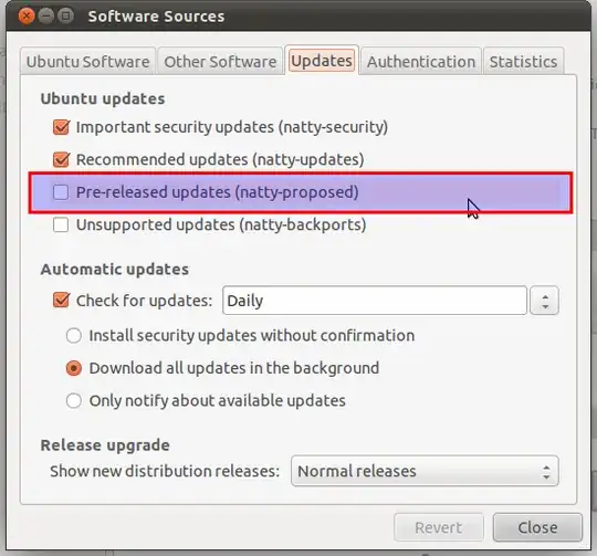

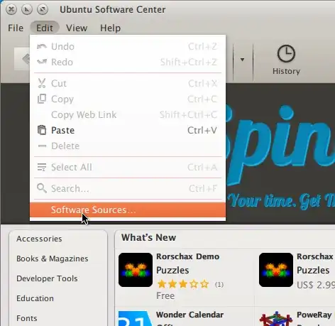

From the wiki page on the -proposed repository:
To enable the proposed archive for Ubuntu 11.04 go to Applications→Ubuntu Software Center→Edit→Software Sources→Updates and ensure that natty-proposed is ticked.
Those directions map well to recent Ubuntu releases such as 10.10, 10.04, 9.10, etc.

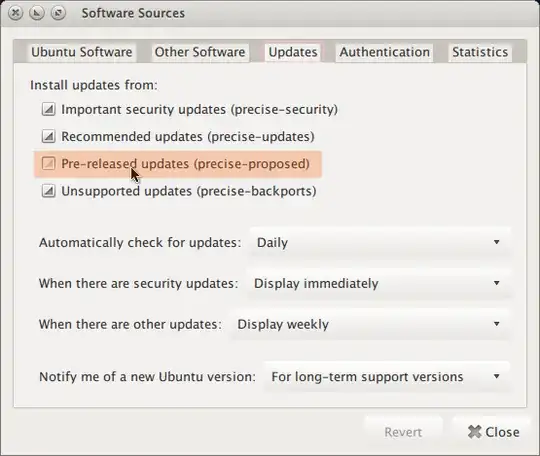

Here are recent pictures from 12.04.

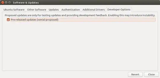

The answer marked as the best one is a bit outdated. From Ubuntu 16.04 the steps are the following:
  1. Open Software & Updates app.
  2. Go to the latest tab Developer Options.
  3. Tick Pre-release updates.
Screenshot
Always up-to-date instruction you can find here: https://wiki.ubuntu.com/Testing/EnableProposed
