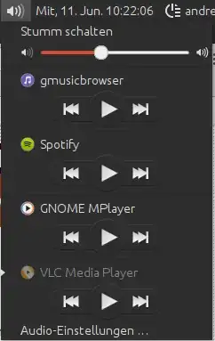

My sound menu integration of VLC seems to be broken (see screenshot), also the multimedia keys do not work any more. Is there a package I am missing?! The back forward buttons in the sound menu do not work either. I'm running VLC version 2.1.4
  • Other players work as expected (such as gnome-mplayer)
  • I'm running 14.04, before everything worked fine...

Inside VLC go to :
Tools > Preferences, select "All" under "Show settings" (bottom left), then navigate to Interface > Control Interface and check the box next to "D-Bus control interface"
