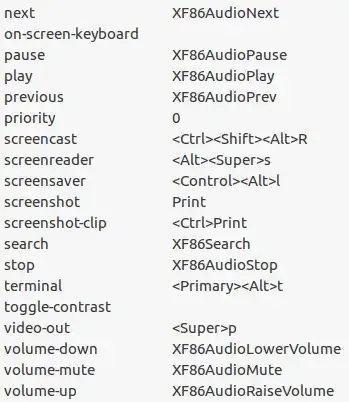

I tried the solution posted here, but that doesn't seem to be the problem. All of my org.gnome.settings-daemon.plugins.media-keys settings seem to be appropriately prefixed by XF86:

Now I can type letters with my previous, next, and play/pause keys. Next, I used xdotool to test keys out:
$ xdotool key XF86AudioLowerVolume
$ xdotool key XF86AudioRaiseVolume
both work, but none of the following do anything
$ xdotool key XF86AudioPlay
$ xdotool key XF86AudioNext
$ xdotool key XF86AudioPrev
This makes me think that Unity is dropping the ball with its media player integration, somehow. I'm not sure how to check that Unity is doing the right thing behind the scenes. Any ideas?
