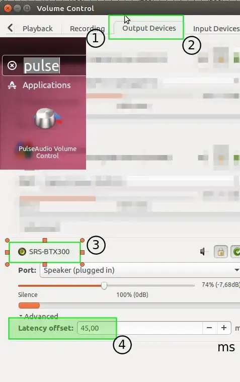

You can open the search bar (CTRL-D in unity, Windows-Key in Gnome) type in "Pulse" or "Volume". Open the GUI tool "Pulseaudio Volume Control", its icon looks like knob or gauge.
There you can select your Bluetooth speaker. Click on Advanced, set the Latency value just like proposed in the other answers . 45 ms or 50 ms seems to work for them, but I haven't found a good value that works for me.
A screenshot is attached. My Bluetooth Speaker is called SRS-BTX300. You don't need to restart bluetooth after changing the latency value.
