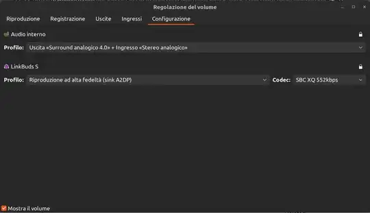

After a while I came up with the idea that the high quality LDAC codec from Sony might be the problem. I used the pulseaudio volume module to edit the codec used for the connection (attached picture, in Italian). SBC codec works just fine.
pulseaudio volume module window:
