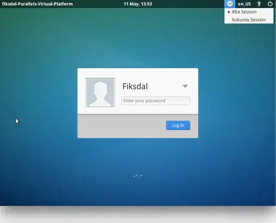

I'm on Xubuntu 14.04.
I ran sudo apt-get install unity. It ran successfully.
But when I log out, I don't get the option to log in again with Unity. This is what I see:
I have tried rebooting. Did I miss something?

The sessions typically are listed on the login screen if they are read from .desktop files provided in /usr/share/xsessions folder. On my system ( default Unity desktop ) I have the following ubuntu.desktop file :
[Desktop Entry]
Name=Ubuntu
Comment=This session logs you into Ubuntu
Exec=gnome-session --session=ubuntu
TryExec=unity
Icon=
Type=Application
X-LightDM-DesktopName=Unity
X-Ubuntu-Gettext-Domain=gnome-session-3.0
I suggest you add the following file , but remove the Icon= part and perhaps X-LightDM-DesktopName=Unity
Try:
sudo apt-get --purge remove unity
Then reinstall unity BUT THIS TIME WHILE INSTALLING IF A SCREEN POPS UP ASKING YOU TO CHOOSE BETWEEN "LIGHTDM" AND SOMETHING ELSE, CHOOSE "LIGHTDM".
ShuaibKunji
  • 453
Try
and
sudo apt-get install ubuntu-desktop
