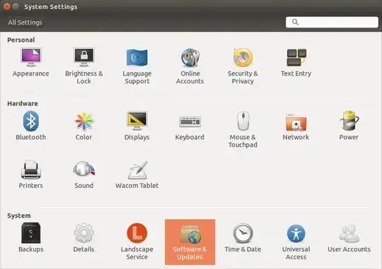

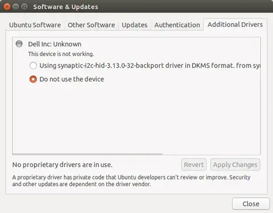

In my case, this problem occurs because of my system start using intel sound driver. Which was not compatible with my Dell laptop. So, I choose 'Do not use the device' and restart my system and problem gone.
Simply follow these steps...
Hope this will help.
