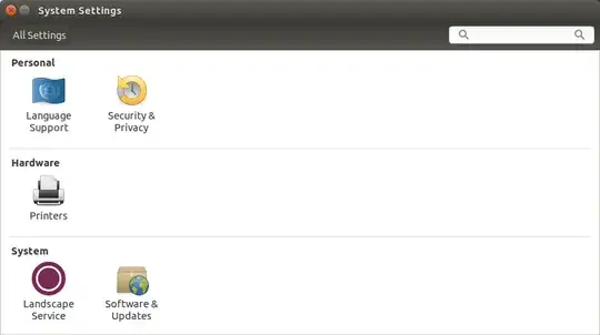

I did a fresh install of trusty 14.04, but a lot of icons are missing. I installed from DVD which was painfully slow and I hope to avoid repeating the process, especially since I started customizing stuff.
Here's my settings window:
System Settings
I've tried:
sudo apt-get install --reinstall gnome-control-center
sudo apt-get install --reinstall gnome-settings-daemon-schemas
None of which changed anything.
Any idea? I wanna edit preferences and none of them are in System Settings, neither in Unity Dash.
casraf
  • 615
50
I had exactly the same problem - same icons missing as well. I had stupidly uninstalled gnome-bluetooth, and nothing was fixing it. So I did what user282306 (r00t) suggested -
sudo apt-get install ubuntu-desktop
And I've got them all back again.
Kudos @user282306 (previously r00t) for the suggestion.

This issue was resolved for me by (re-)installing unity-control-center
apt-get install unity-control-center.
I didn't want to re-install the whole ubuntu-desktop because it was going to install a bunch of packages I didn't want/need and use another 100MB of space.
Compared to just 4MB with unity-control-center

Most likely (probably due to some dependency issue) below packages were removed:
  • unity-control-center-signon
  • gnome-control-center-unity
This command should resolve this issue:
sudo apt-get install unity-control-center-signon gnome-control-center-unity
