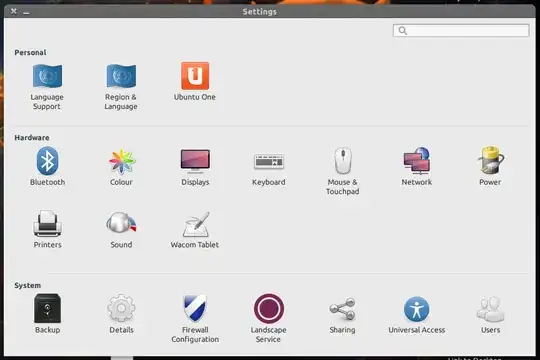

The Control Panel was fine, but the for no apparent reason, PRIVACY, BACKGROUND and a host of other icons have vanished...
My system seems pretty messed up after the upgrade... Shutdown, Reset, and Logout from the menu no longer work either...
Settings with, presumably, icons missing

I had this problem with Xubuntu. I restored the icons in the settings manager by editing the .desktop files in ~.local/share/applications/ and changing
Hidden=true
to
Hidden=false
