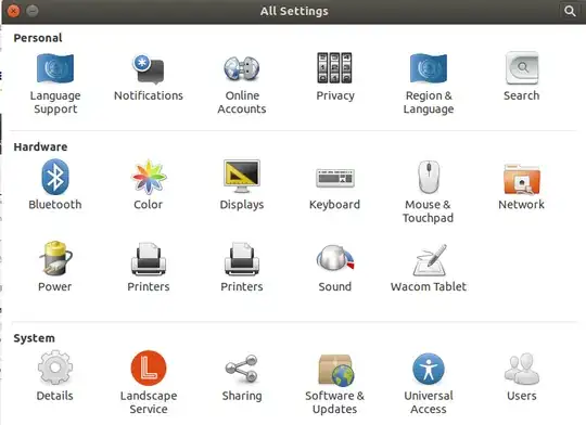

Option 1: Maybe the setting is called differently in your language?
You can open the System Settings window in English by running the following command either from a Terminal (Ctrl+Alt+T) or the Unity HUD (Alt+F2):
LANG=C unity-control-center
You should get a window like the one below.
System Settings in English

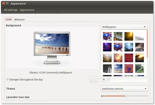

As you can see, the Appearance settings belong to the icon with the purple monitor. Clicking it will display you a window that should look about like the following one.
Appearance Settings (Look)

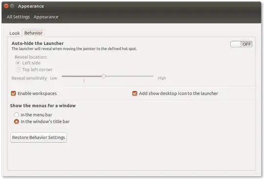

Clicking on the Behaviour tab will then finally take you to the options of your interest. Here you can tick Enable workspaces.
Appearance Settings (Behaviour)
