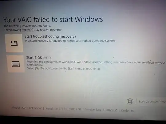

I got my new SSD today, and used dd to burn the Ubuntu 14.04 image onto a USB. Then I swapped the internal HDD with my new SSD. I booted into the USB, and installed Ubuntu to the SSD. I manually partitioned giving 30 GB to the root and 2 GB as swap. Then it got installed.
The only problem is that I can't boot into the new installation. I get this:
Boot
So I plugged in the usb, and from it's grub, I manually booted into the installation. That is how I am typing this. Now I proceeded into trying to update grub. It runs with a warning:

Everything is fine, other than the fact that GRUB residing in the SSD is not being loaded during booting. How do I fix this? My laptop is a Sony VAIO SVF14212SNW

If your computer is UEFI you must first create EFI Boot Partition and your SSD shouldn't use MBR anymore but GPT. I had the same problem with my Sony VAIO. Or if you don't use Windows at all, then change UEFI to BIOS. For sure, Sony VAIO's UEFI implementation sucks.
