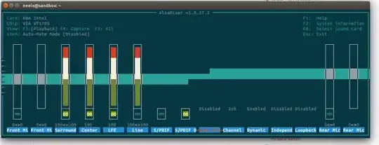

after the upgrade, in AlsaMixer my Automute was enabled, I've disabled it and sound is back
